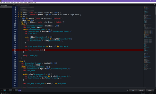

This project implements syntax highlighting and autocompletion for mIRC msl. It currently supports:
All /Commands
All $Identifiers
All on EVENTs
Goto Loop highlighting
Popups
#Groups
Comments (; and /*)
@Windows
Numerics
User Variables
Params ($1, $2, etc)
Operators (ison, iswm, $+, >=, <=, etc)
Logic (if, else, while, etc)
This project aims to make Sublime Text the premier choice for developing mIRC msl. If you encounter any problems, please create an issue.
Highlighting
Highlighting currently supports all commands and identifiers in mIRC. In addition "on/ctcp/raw events" will also highlight. I try to cover all cases including: commands on new line, commands inline, commands after a |, commands after a {, etc. I welcome any suggestions for improvement.
Auto Completion
Autocomplete will work for all /commands and $identifiers. They will display in the autocomplete popup. Additionally, I have added support for tabbing through the full syntax of /commands through /color (alphabetical). I am adding support for more and hope to support displaying the full syntax of all remaining commands and identifiers in the future.
