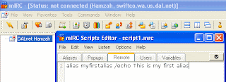

  4. There are two more other ways to create aliases besaides using Aliases editor, they are :
    1. The first one is to write aliases in the Remote tab section in the Scripts Editor, by using alias declaration. The basic syntax for this method is alias alias_name contained_command(s) . See the below screenshot for the example.
      on this example the function of alias declaration is to tell mIRC that myfirstalias was declared as an alias.
