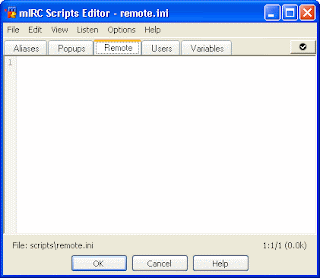

Remote
Remote : Events
Remotes are event based. Remotes are mIRC interpreted programs which responds to events. You should have no difficulty in understanding the concept if you can think logically. Events like when you get a private message or somebody says something on the channel or you are voiced or someone is banned or you click a button in a dialog box. The list of events are too many to enumerate them all here. We'll see some of the common events later.
If you are still not clear about events, let me give you some real life examples. When you are hungry, you eat food. Being hungry is an event. When it gets dark you turn on the lights. Getting dark is an event again. When you are pinched you feel pain. Pinching is an event. Hope these examples gave you some idea atleast. Even if you are not clear yet don't worry, with the examples I'll give below it will become clear to you.
The basic Remote structure is of three types.
