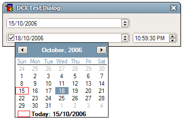

| DateTime Picker |
The DateTime Picker control allows users to select a date or time in a neat way, automatically enclosing the calendar control and also providing UpDown spinners on date/time values.
It is highly recommended that you familiarise yourself with how the mIRC functions $ctime and $asctime() functions work before using this control.
Root control: Date And Time Picker
