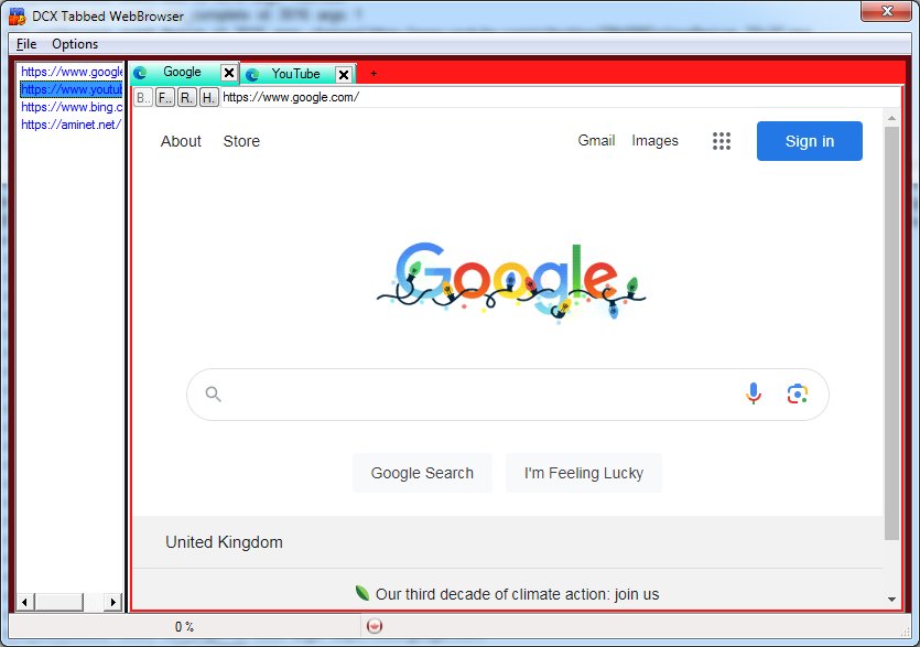

| Web2 Control |
WebView2 HTML control. Root control: Static
NB: This control requires WebView2Loader.dll to be present somewhere LoadLibrary() can find it, or in the same directory as dcx.dll.
NB: The control also requires WebView2 installed & will try to install it if not found.
