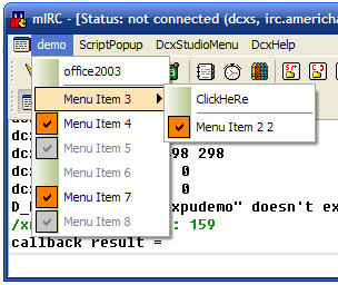

XMenuBar is a command implemented to replace the mIRC menubar using XPopup menus.
XMenuBar Marking and Callback
Just like with XDialog, you must "mark" the mIRC menubar prior to using XMenuBar.
To mark the mIRC menubar, use /xmenubar -M and specify a callback function of your choice.
The callback function will only be passed 1 parameter, and that is the MENU_ID. The menu ID is sent to the callback function to allow customisation of event flow. To stop mIRC from processing the menu command, return $true from the callback alias.

The callback parses menu clicks before mIRC gets a chance to process them. If the custom XPopupMenu has an ID which matches the ID of an existing mIRC menu item, it can be used to call the mIRC functionality.
For example, the menu ID for the mIRC Options dialog is 159. If you used /xpop -a and specified the ID 159 and added the XPopup menu to the XMenuBar, the item will open up the mIRC Options dialog when clicked.
Additionally, there is a special menu called the scriptpopup menu. This allows you to add the original mIRC scriptable popup menu on your XMenuBar. The usage of the other special menus (mirc and mircbar) has been disabled for the XMenuBar.
Note: For custom menu commands which are specific to only your script, it is advised you use an ID starting from 15000. This is to prevent any clashes in existing IDs and XPopup menu items.
