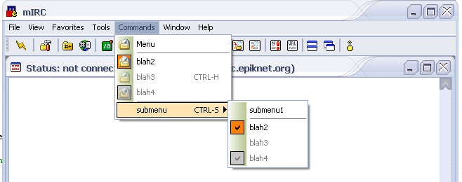

Both menus can have their style, colors and icons modified using the /xpopup command. The command switches -c/-d are disabled for these menus. You cant use /xpop to modify these menus either. To add icons the mIRCs popups menus (status, menubar, channel, query and nicklist) you need to add the icons the menu image lists using /xpopup -i/-j. The icon index number needs to be inserted in the mIRC popup menu syntax like this:
Remember that the same mIRC popup rules still apply. It is only the menu item text syntax that needs to be shaped for XPopup to interpret it correctly. If the [VTAB] element is not present, XPopup assumes that the item text is a regular item (no icon element).
You can also add $idents in your menu item text like mIRC has always permitted to create your own tri-state check system for example with the use of custom icons.
The image below is an example of a mIRC menubar popup menu skinned with XPopup which includes icons.

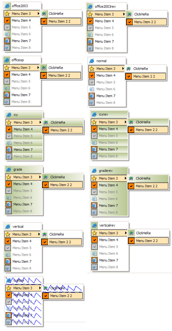

| DCXML for XPopup |
DCXML also allows users to create menus. The syntax and format is similar to the XML used for creating dialogs, but simpler.
| Format: |
/dcxml -p [MENUNAME] [DATASET] [FILENAME] |
| Example: |
/dcxml -p menuName LagBarMenu $qt($mircdir $+ dc.xml) |
In the given example, a menu named menuName will be created from the dataset specified by the name LagBarMenu.

Below is a list of attributes and which tag they apply to.
Note: All attributes which apply to the popup tag will also apply to the global all tag.
| style |
| Applies to: |
<popup> |
| Description: |
The XPopup style. |
| Default value: |
office2003 |
| Valid values: |
See /xpopup -c for a complete listing of styles. |
| Example: |
<popup style="grade"> |
