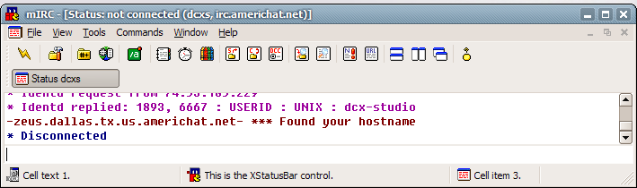

The /xstatusbar command is used to create and control a statusbar docked directly within the main mIRC window, without the need of creating a dialog to host it. Root control: StatusBar

| This command enables/disables a statusbar in the mIRC window and applies the styles specified. |
| Syntax: |
/xstatusbar -A [1|0] (STYLE) |
| Example: |
/xstatusbar -A 1 notheme |
| Parameters: |
| STYLE |
Styles supported by the StatusBar control. |
| | Note.- Syntax for controlling the mIRC StatusBar using /xstatusbar is identical to the syntax for the DCX StatusBar control.
- eg. /xstatusbar -l 200 200 100 -1
