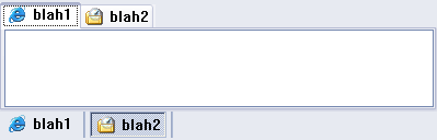

The tab control is a collection of controls which allows the user to select a visible page at a time. Root control: Tab
| Control Styles |
| These control styles are available when creating a Tab control. Remember that the general styles disabled, group, hidden, notheme, tabstop and transparent apply to all DCX controls except the embedded Dialog and Window controls. |
| alpha |
The control is alpha blended. |
| bottom |
The tabs are aligned at the bottom. (See note below) |
| buttons |
The tabs appear as buttons like a toolbar. |
| closable |
The tabs have a close button on the right of the tab. |
| fixedwidth |
All tabs are the same width. |
| flat |
The tab buttons appear flat. (Only with buttons) |
| flatseps |
The tab separators are drawn as flat (Only with buttons and flat). |
| gradient |
A gradient background is applied. (Only works with closable) |
| hottrack |
The tab item under the mouse is highlighted (may not work on some systems). |
| multiline |
The tabs aline themselves on multiple rows (default is single row). |
| right |
The tabs are aligned verticaly right (used with vertical). (See note below). |
| rightjustify |
The width of each tab is increased so the tab fills the entire width of the row (Only with multi). |
| scrollopposite |
Unneeded tabs scroll to the opposite side of the control when a tab is selected. |
| vertical |
The tabs are aligned verticaly left. (See note below). |
| | Note.- Vertical and bottom tabs are not supported correctly in XP Themes. The control works, but the tabs are not drawn properly. There is no easy fix for this at the moment. It is a bug in the windows theme system, not in the API.
