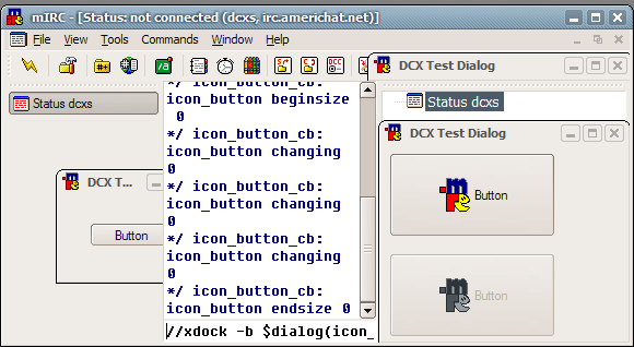

XDock is the complete rewrite of UltraDock. It handles docking of all types of windows and customisation of behaviour upon resizing.
| /xdock Commands |
| The /xdock command is used to force the positioning of a window within another window, with specific behaviour. |
/xdock -b |
| This command docks a window to the mIRC TreeBar. |
| Syntax: |
/xdock -b [HWND_DOCK] [+FLAGS] |
| Example: |
/xdock -b $dialog(dcx).hwnd +h |
| Parameters: |
| HWND_DOCK |
The HWND of the window you wish to dock. |
| +FLAGS |
Flags for docking into the mIRC TreeBar. |
| s |
Docked window will be resized to fit its parent width & height automatically. |
| h |
Docked window will be resized to fit its parent width automatically. |
| v |
Docked window will be resized to fit its parent height automatically. |
| n |
Docked window will not be resized automatically. |
| o |
Uses the old style treebar docking. This is when the docked window is on top of the treeview control within treebar. |
| | | Note. Dialogs should not be docked within the INIT event as they are not yet visible. This can be fixed by using a timer. |

| XDock Signals |
| XDock uses the DCX signal to handle events. To activate signal messages for docked windows, refer to /dcx xSignal |
size |
| Triggered when a docked window is resized. |
| Syntax: |
/signal DCX size [WINDOW_TYPE] [HWND] [WIDTH] [HEIGHT] |
| Example: |
/signal DCX size mIRC_Toolbar 345564 1024 32 |
| Parameters: |
| WINDOW_TYPE |
Information about which window type this information is describing. |
| mIRC |
The mIRC window has resized. |
| mIRC_Switchbar |
The mIRC SwitchBar has resized. |
| mIRC_Toolbar |
The mIRC ToolBar has resized. |
| mIRC_TreeList |
The mIRC TreeList has resized. |
| ListBox |
The channel ListBox has been resized. |
| Custom |
A custom window has been resized. |
| HWND |
The HWND of the window being sized. |
| WIDTH |
The new width of the window. |
| HEIGHT |
The new height of the window. |
sizemove |
| Triggered when a docked window starts & stops being resized or moved. |
| Syntax: |
/signal DCX sizemove [WINDOW_TYPE] [STATE] [HWND] |
| Example: |
/signal DCX sizemove mIRC start 123456 |
| Parameters: |
| WINDOW_TYPE |
| mIRC |
| mIRC_Switchbar |
| mIRC_Toolbar |
| mIRC_TreeList |
| ListBox |
| Custom |
| STATE |
Either starting or ending the resize/move action |
| start |
The window is being modified. |
| end |
The window is has finished being modified. |
| HWND |
The HWND of the window being changed. |
