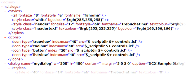

One of the major benefits of using DCXML is that you can define a multiple controls styles in one easy definition. You can style per ID, Class & Type. On top of that you can set global and local style definitions.
Style definitions are grouped in the <styles> element. This <styles> element can be a child of <dialogs> which will effect ALL dialogs or <dialog> to only style a certain dialog. You can also style directly on the <control>.
<dialogs>
	<styles>
		<style type="text" fontname="Trebuchet MS"/>
	</styles>
	<dialog>
		<styles>
			<style type="text" fontname="Tahoma" />
		</styles>
		<control type="text" fontname="Verdana">
        	This text is in Verdana
		</control>
In the above example the text control will appear in Verdana because the most explicit style will always be applied.
If we remove the fontname attribute on the control the text will be in Tahoma because that's more explicit then the definition in the global styles definition.
<dialogs>
	<styles>
		<style type="text" fontname="Trebuchet MS" />
		<style class="TahomaText" fontname="Tahoma" />
		<style id="10" fontname="Verdana" />
	</styles>
	<dialog>
		<control class="TahomaText" type="text" id="10">
	</control>
In the above example the text will be in Verdana because id is more explicit then class and text. The exact order of precedence is: id, class, type. If DCXML can't match id it will try to match class and then match on type.   In addition to <style> there's also an <all> element which is the exact same but will apply to every control on the dialog(s). Note: This element has the lowest precedence and will only be applied if DCXML cant match on id, class or text.
Cascading Icon Definitions go to top
Icon libraries for controls are applied in a similar way as style definitions.
<dialogs>
	<icons>
		<icon type="treeview" indexmax="40" src="$_scriptdir $+ controls.icl" />
		<icon class="Pastel" indexmax="40" src="$_scriptdir $+ pastel.icl" />
		<icon id="10" index="20" src="$_scriptdir $+ pastel.icl" />
		<icon type="listview" indexmax="40" src="$_scriptdir $+ controls.icl" />
	</icons>
Like styles icons can appear as child of <dialogs> and <dialog>.
DCXML will first try to match in the <dialog> icons definition. When unsuccessful it will parse the <dialogs> icons definition. Use the index attribute if you want to load up a single icon, for multiple icons you can use indexmin and indexmax. DCXML will loop from indexmin and indexmax and load up those icons. Indexmin and indexmax default to zero and min has to be smaller then max.

<styles>
styles is an element that groups style elements.
Child nodes: <style>
Parent Nodes: <dialogs>(global), <dialog>(local)
<style>
style allows you to style a control/class or id.
Child nodes: none
Parent Nodes: <styles>
<all>
Handy element to style EVERYTHING on your dialog.
Child nodes: none
<icons>
icons groups icon elements
Child nodes: <icon>
<icon>
icon allows you to specify a control/class or id's image list
Child nodes: none
Parent Nodes: <icons>
