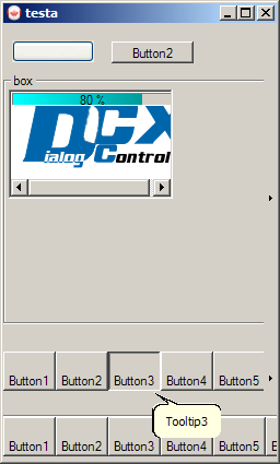

The pager control manages the automatic scrolling of its child controls. This can be created within a dialog, panel or box control. It can contain a toolbar, rebar, panel, tab, box, image, pager, @window or dialog control. Root control: Pager
| Control Styles |
| These control styles are available when creating a Pager control. Remember that the general styles disabled, group, hidden, notheme, tabstop and transparent apply to all DCX controls except the embedded Dialog and Window controls. |
| autoscroll |
Causes the control to scroll when the mouse is over the scroll button. |
| horizontal |
Sets the pager control as horizontal. (Default is vertical) |
