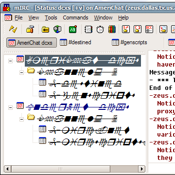

/xtreebar -f |
| This command allows you to change the mIRC Treebar font. |
| Syntax: |
/xtreebar -f [+FONTFLAGS] [CHARSET] [SIZE] [FONTNAME] |
| Example: |
/xtreebar -f +i default 20 Verdana |
| Parameters: |
| +FONTFLAGS |
Font style flags. |
| a |
Font is anti-aliased. |
| b |
Font is bold. |
| d |
Default font. |
| i |
Font is italic. |
| s |
Font is strikedout. |
| u |
Font is underlined. |
| CHARSET |
Can be any of the following: ansi, baltic, chinesebig, default, easteurope, gb2312, greek, hangul, mac, oem, russian, shiftjis, symbol, turkish, vietnamese. |
| SIZE |
Font size in points. |
| FONTNAME |
Font name. Ex: Tahoma, Courier New, Arial, ... |
