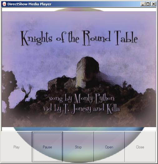

| Directshow |
The DirectShow control allows playback of media files. Formats which can be played will depend upon the codecs avaiable on the system. Root control: Static
