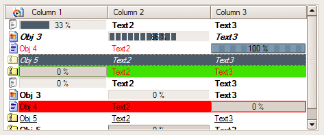

This control enables you to create a listview in 4 different view styles: icon, small icon, list and report. Root control: ListView
| Control Styles |
| These control styles are available when creating a Listview control. Remember that the general styles disabled, group, hidden, notheme, tabstop and transparent apply to all DCX controls except the embedded Dialog and Window controls. |

| | | Note. |
| /xdid flags |
/xdid -a |
| This command lets you add an item to the listview. |
| Syntax: |
/xdid -a [DNAME] [ID] [N] [INDENT] [+FLAGS] [ICON] [STATE] [OVERLAY] [GROUPID] [COLOR] [BGCOLOR] (TEXT) [TAB] [+FLAGS] [ICON] [OVERLAY] [COLOR] [BGCOLOR] (TEXT) [TAB] ... |
| Example: |
/xdid -a dcx 4 1 0 +cbku 1 0 0 0 $rgb(170,213,255) $rgb(0,255,255) text $chr(9) + 0 -1 $rgb(10,210,250) $rgb(255,0,255) text2 $chr(9) + 0 -1 $rgb(120,255,210) $rgb(255,255,0) text3 |
